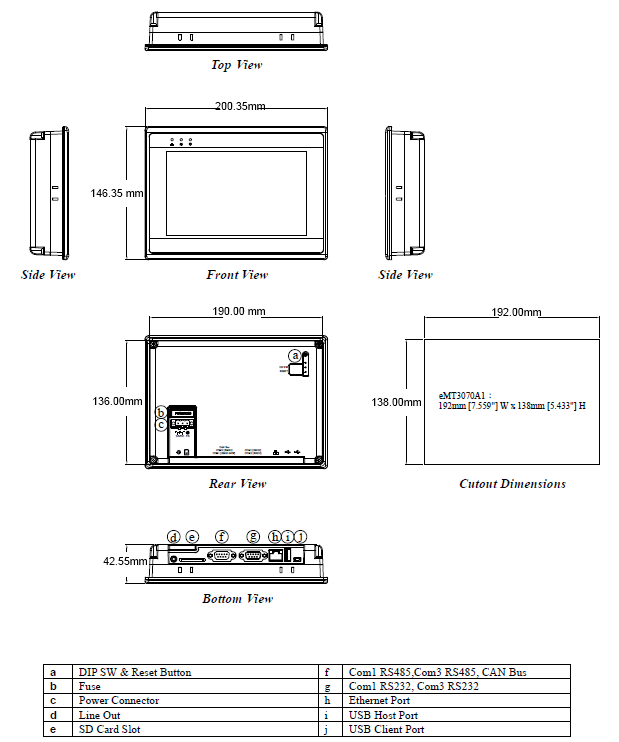

Габариты панели оператора Weintek eMT3070A
200x146x42.5 мм
192x138 мм

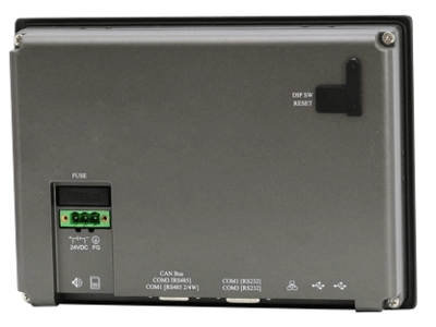

Схема соединения Weintek eMT3070A
COM2[RS232]
COM2[RS232]
1 | ||
2 | RXD | |
3 | TXD | |
4 | ||
5 | GND | GND |
6 | ||
7 | RTS | TXD |
8 | CTS | RXD |
9 |
COM1[RS485 2/4w]
COM3[RS485]
CAN BUS
COM1[RS485 2/4w]
COM3[RS485]
CAN BUS
Pin # | COM1 (RS485 2W) | COM1 (RS485 4W) | COM3 (RS485) | CAN BUS |
1 | Data-(B) | RX- | ||
2 | Data+(A) | RX+ | ||
3 | TX- | |||
4 | TX+ | |||
5 | GND | GND | GND | GND |
6 | Data-(B) | |||
7 | CAN_L | |||
8 | CAN_H | |||
9 | Data+(A) |
