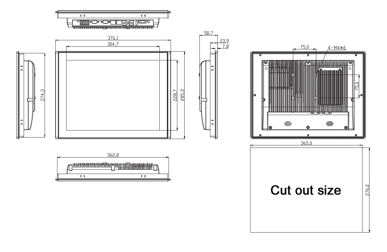

Габариты панельного компьютера IFC-515Ci5-7200
376.1x285.3x58.7 мм

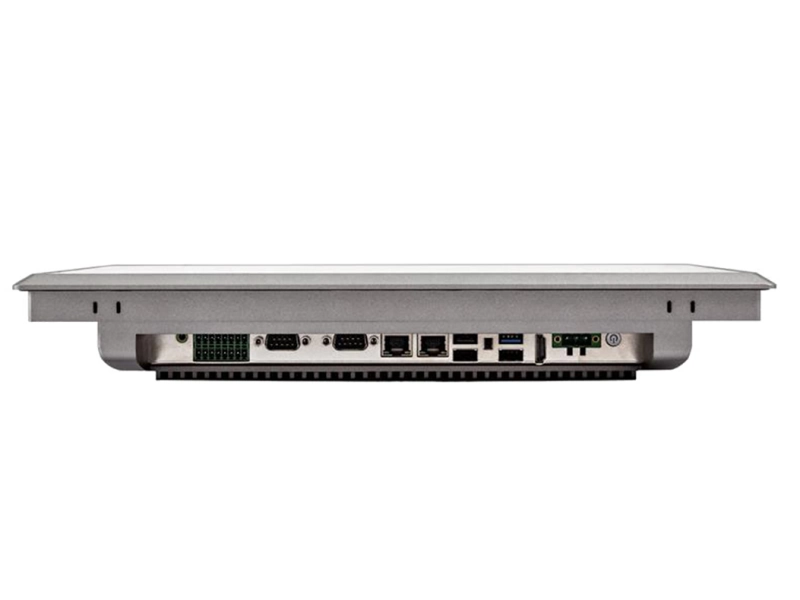

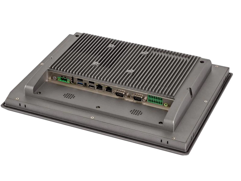

Схема соединения IFC-515Ci5-7200
COM1/COM2
COM1/COM2
Pin # | RS232 | RS422 | RS485 |
1 | DCD# | TX+ | DATA+ |
2 | RXD | TX- | DATA- |
3 | TDX | RX+ | |
4 | DTR# | RX-+ | |
6 | DSR# | ||
7 | RTS# | ||
8 | CTS# | ||
9 | RI# |
COM3/COM4/COM5/COM6
Phoenix terminal
Pin # | Signal | Note | Pin | COM4 | Note |
1 | COM3 DATA+(A) RS485 | COM3 | 2 | COM4 DATA+(A) RS485 | COM4 |
3 | COM3 TXD RS232 | 4 | COM4 TDX RS232 | ||
5 | COM3 DATA-(B) RS485, COM3 RXD RS232 | 6 | COM4 DATA-(B) RS485, COM4 RXD RS232 | ||
7 | GND | 8 | GND | ||
9 | COM5 TXD RS232 | COM5 | 10 | COM6 TXD RS232 | COM6 |
11 | COM5 RXD RS232 | 12 | COM6 RXD RS232 |
